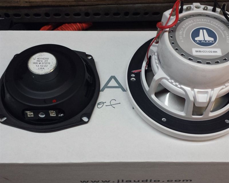

i wanted to ask about whats behind the speakers inside... i understand the reason victory has the enclosure is to TRY and bass response instead of just NOT having a enclosure behind the speakers all together.. about 1-2 years ago i has a speaker failure and i went to buy Non-victory kickers.. and they wouldnt fit inside the front with the enclosure... so i stole the rear speakers and moved them up front and put the kickers in the rear... i was just wondering whats going on behind the speakers thats all.. =)
are you able to show photos of whats going on inside ? btw i am interested. i hate the front speakers !

I used JL Audio MX Series marine speakers, which of course are waterproof, sound awesome and are designed for a "free air" or infinite baffle mounting. Basically if you try to use a small enclosure, they sound like crap, but removing the factory baffles and allowing them to "breathe" into the entire fairing gives great midbass. So essentially, the rear of the speakers are entirely open. I did place some small strips of Dynamat however on the fuel tank and inside of the plastics to help reduce resonance. They sound excellent in the Vision
