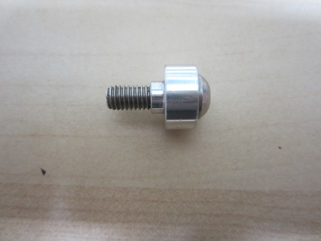

I mounted a new fender today using a couple of spacers I made. The right and left are different since the plastic thickness varies. The good thing is that the thickness is consistant from fender to fender or so it seems. I made the spacers to have a .005" compression on the plastic which is not much but certainly won't crack it. We'll see what happens.

What I've done is real close to what you've done other than I didn't make the spacer.

Just thought I'd mention that since installing the last new fender with custom made spacers as pictured above the fender has been fine. It's been 5 months which is longer than the first few lasted. I think the amount of compression applied by the original screws is what's causing the cracks. If that's true then it wouldn't take much for the factory to come up with updated screws. Doesn't look like they're interested though.
