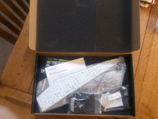

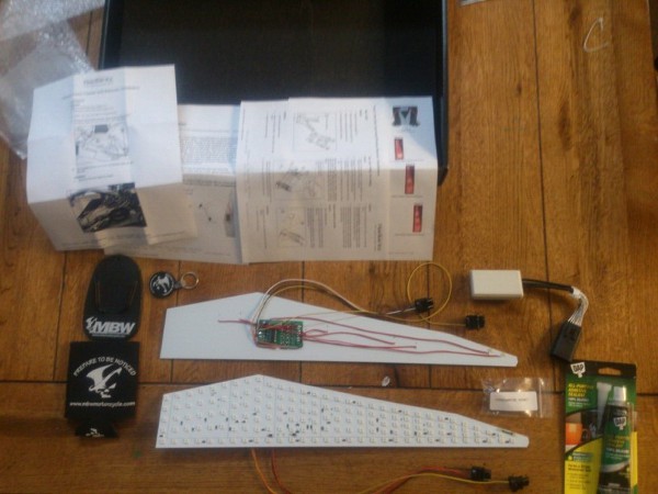

In the box -
Very well packaged. Looks like something you would buy in a glass case at the dealer.
It even came with a key fob, drink koozy and kickstand rest.

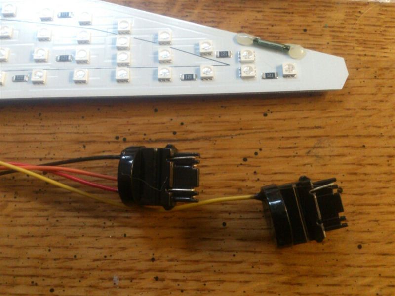

The connections look just like a 3157 bulb, except there are only two per side.

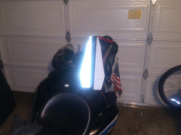

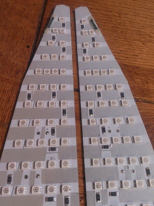

The only thing I have done that is different, was to add retro-reflective tape in between the LEDs.
I contacted MBW prior and they said that was fine as long as they weren't metal, which could possibly short it out.
I checked with an ohm meter to make sure they were non-conductive, and as an added measure, did not get close to any contact points.
You can see the difference, and that is just my phones LED flash.
DOT requires all vehicles have a red reflective surface to the rear. Most vehicles it is built into the tail-lights. Euro-style have the reflectors on the bumpers.
Our lenses were originally somewhat reflective, but they also had a reflector mounted to the license plate frame.
I took off the license plate frame reflector, and now don't have the lens mirrors reflecting back headlights either, so I felt this was a good solution.

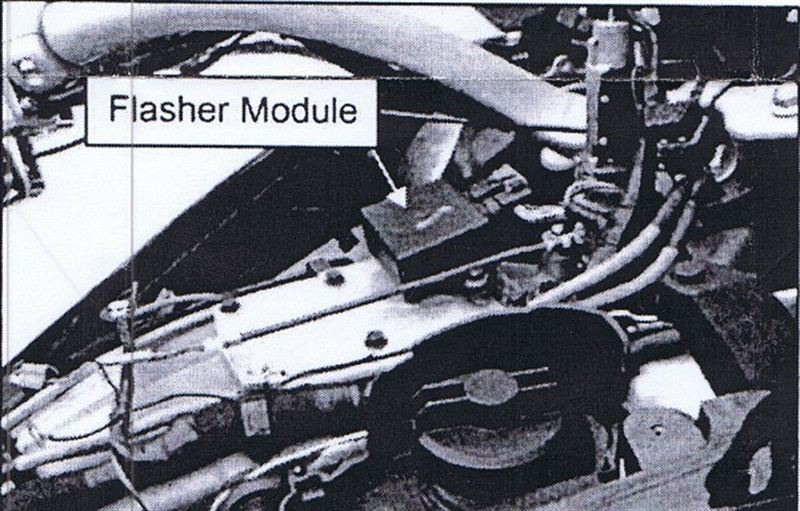

The install took a little longer than normal than average. I was already running LEDs along with a "Back-Off" brakelight controller. This and all the load equalizers had to come off. The new blinker controller replaces the OEM one under the radio panel.
Just unplug the old, and plug in the new. A least there was no problem with the 2010 version.

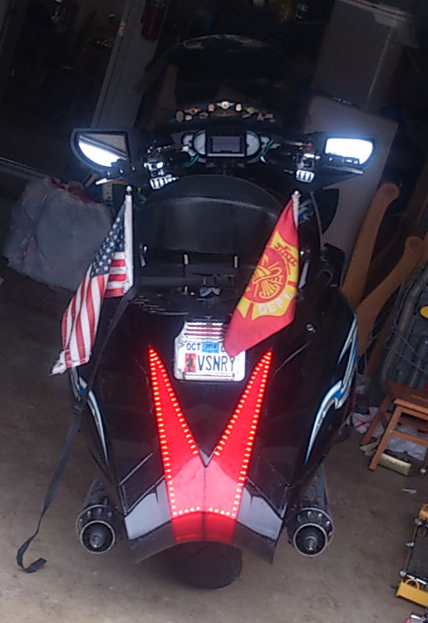

Once installed, the bike looks like it was designed to be that way. I really like the way the running lights outline the lenses. Not too bright or overbearing, but very noticeable.
