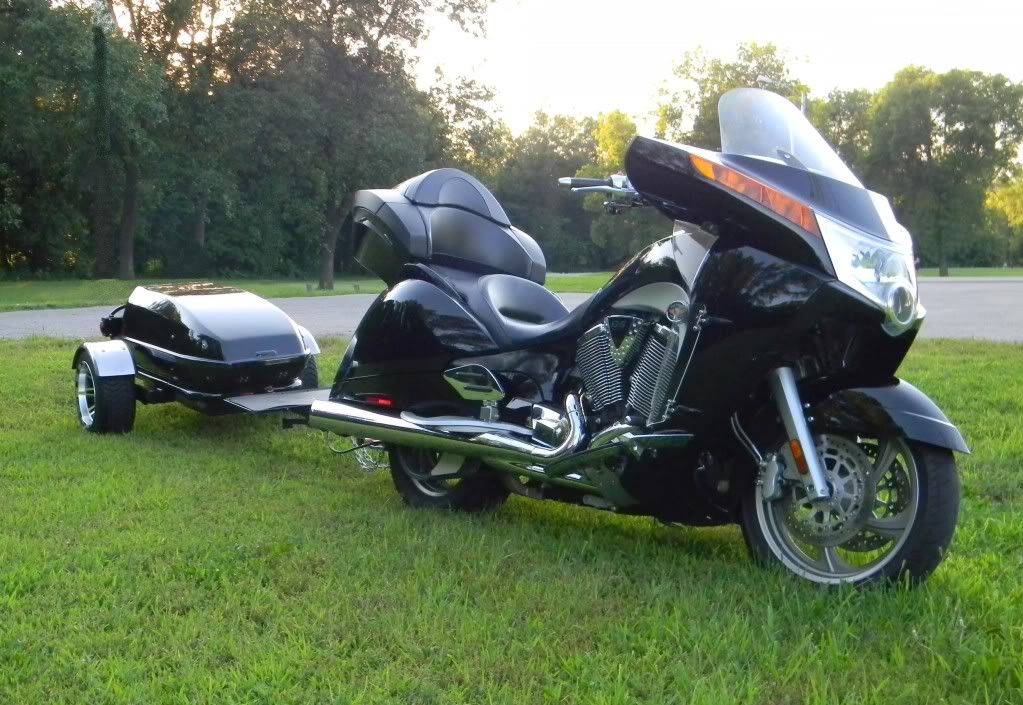

I enjoy my cargo trailer. I use it on a trip 1-up or 2-up...the main reason I like the trailer is most of the weight is in the trailer not on the bike. The only additional weight added to the bike is the 25 - 30 lbs of tongue weight. When I use the trailer the saddlebags are virtually empty except for the casual, easy access things, like hat, camera, etc. If the wife isn't along, I take the trunk off the bike and get rid of the 'high weight' and hook the trailer on...works great. I have had numerous trailers...some home made, some factory made. My current unit is a 'Road Dog'.
http://www.roaddogtrailers.com/
Here's my bike & trailer -
0031.jpg picture by FlatsixV2
